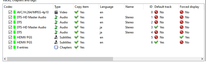

Take this Anime Episode for Example you would think it would set the Audio to Jap and Sub to Eng but nope
Audio is Eng and no subs…
Then there is movies.
I set up the forced sub title to be default subtitles and i still need to set them manually.

Unfortunately PLEX doesn’t actually honor the default flags but it should honor the forced flag (which based on your screenshot I think you are misunderstanding how that is actually supposed to work which is a common occurrence). I honestly have no clue how PLEX actually handles the audio it selects as I always create a stereo track if there isn’t one and set that as both the first audio track and default (when I add media I manually select the best audio track [generally the surround track] for my account and any other account I control/have access to that I want to have the best audio track).
This actually causes a couple of issues, the one you mentioned and the fact that PLEX decided that a stereo track is always going to be preferred over a mono track, so if you have a mono track as the default track but then have, say, a commentary track which is stereo as the second, that will auto get selected (A Christmas Story is a perfect example of this as the main track is mono and it had a commentary track which was stereo).
That said you can set auto select options for audio and subtitles by going to Settings from the web app (the wrench icon) and then in the left menu click on Account at the top. On the right panel you will see a “Audio & Subtitle Setting” that you can then click on and it will expand with options you can change. If you check the “Automatically select audio and subtitle tracks” and then set your preferred language for audio and subtitle in the respective drop downs and set the “Auto-Select Subtitle Mode” drop down to “Shown with Foreign Audio”, you’ll get the subs in your preferred language auto selected when you select the foreign audio (as compared to what you selected for your preferred language). Once you set those (and you confirm your forced flags are set properly after reading the next paragraphs), when you select the Japanese track, the first English subtitle would automatically be set.

No I get how forced works.
Signs, foreign dialog in eng track may have a forced eng sub to go with it.
And setting an account wide default does not fix the problem just makes it worse.
ATM I am starting the horrible task of setting up a duplicate library for anime so I can have one set with eng and the other with jap just have to edit them as they get added.
Was playing around with Emby and its not much better.
It grabs the defualt audio track I set for anime (Jap) but is using the forced Eng sub not the default Eng sub…
Looks like both plex and Emby have no idea what forced and default mean.
Still going to set this all properly with MKVToolNix in the hopes that one day the application figures out what the flags do…

I use MKVtoolnix to remove those language tracks (audio or subtitles) I don’t want.
If there are forced English subtitles natively on the disc, that’s telling me there is a need for them so I include them AND make sure the ENG and FORCED fields are set.
I do have the option to use forced but it does not always work.
And the auto option is crap… as its is this all or nothing.
So automatically my Anime with both English and jap audio tracks will now default to English.
If this was a per library option you could get away with it, but not at the account level.

Also, just to point out, the screenshot you posted of the audio and subtitle settings screen, the two settings you are showing are for searching subtitles and not for the actual auto selection.
