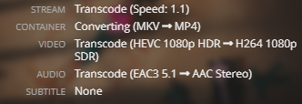

Unfortunately, hardware transcoding still isn’t working for me for HDR content, only when HDR tonemapping is enabled.
HDR Tonemapping enabled:
HDR Tonemapping disabled:
What else could be the cause of this behavior? Where could I look on my server / host OS to fix it? I’ll admit, I’m lost :frowning:

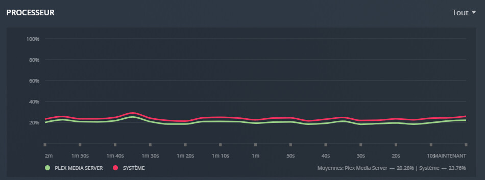

HDR tonemapping enabled, and here is an HDR to SDR transcode… Using hardware!
Just for fun, I tried to start 10 of those streams (which was totally impossible before, as a single stream being transcoded drained all of my CPU) and of course, it works flawlessly since it’s now using the iGPU!
CPU being super chill while 10x HDR → SDR transcodes are going on…
Anyway, thanks a lot to both of you for your help on this topic, it helped me as well!

CPU usage before and after
