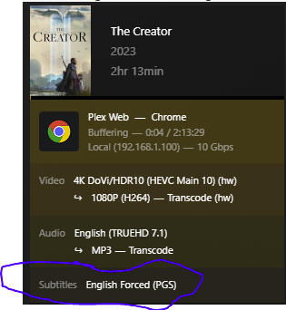

Does Plex say it’s doing HW transcoding, similar to this?
It is showing HW Transcoding, but it is using CPU and not GPU.
The GPU is doing something, probably audio, but nothing for the video.
It’s using the GPU, it says (hw) next to both the video lines. Your CPU is doing audio transcoding from TRUEHD 7.1 to MP3

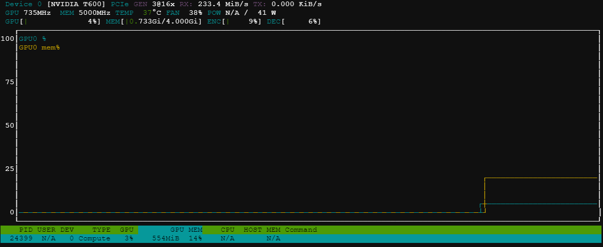

Check your nvidia-smi output for the plex transcode process
Considering what I have seen the usage to be during initial testing and this same file playing smoothly with out buffering, I am still of the opinion that there is something going on. I also wouldn’t expect the audio track to be causing this much CPU usage. As again initial testing was showing next to nothing hitting the CPU.
I can do a rebuilt of the LCX and update with screen grabs showing the usage on NVtop and Plex.
From the LXC
From the Host.
This was also the same during initial testing.
I would tell you that its not a GPU issue. If you are seeing (hw) on both the video lines in plex and the plex transcoder process is showing up in nvidia-smi then you can be pretty certain it is both decoding and encoding the video with your GPU.
I’m not saying there isn’t an issue, I’m saying its not a GPU issue.
https://www.reddit.com/r/PleX/comments/nhfnnz/extensive_cpu_usage_when_displaying_subtitles/
Could it be your subtitles turned on?
I’d agree with what you’re saying if performance wasn’t so poor.
Everything I can see on the server is saying it’s working, but the high CPU usage and buffering is suggesting otherwise.
Wondering what else I can use to determine where the issues are.
