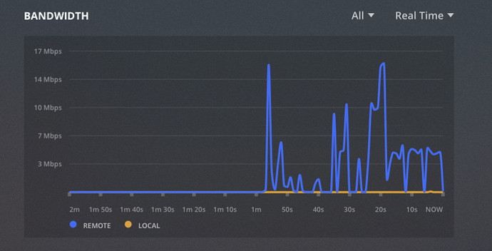

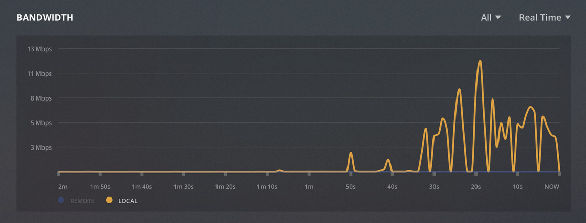

I can confirm from Plex logs that it receives the correct X-Forwarded-For header, and even acknowledges that it’s using it (screenshotted)
However, the bandwidth dashboard shows remote traffic as local (also screenshotted).
From this I assume that other important settings (“Remote streams allowed per user” for example) are also ignored.

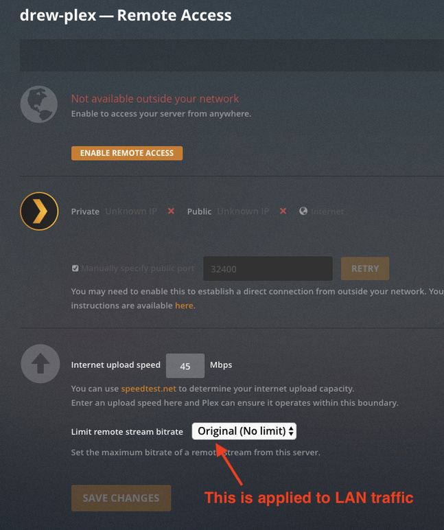

I have the same problem but with an extra twist.
Plex Bandwidth monitor is treating all traffic as local, but the bandwidth limiter is treating all traffic as remote. LAN IPs that are visibly identified as LAN in Tautulli are being restricted from passing the Remote stream bitrate limit when it’s set on the Remote Access Settings page.
I have it set to Unlimited to bypass this issue for now.
