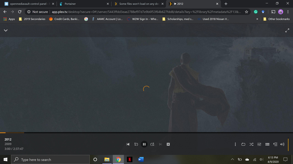

I do see the media in my Plex library, with thumbnails and everything, except when I go to play it, it will spin loading at either 13 or 33% then quit out.
All my video files are in a single library on an external drive hooked up to my Debian OS. Some will play and some won’t (I’m not quite sure why the difference).

and okay there seems to be several problems - on my Roku, the files load and load and load and then quit statesing “Playback has stopped due to multiple playback errors, please check your connection.”
On my PC (Dell XPS 13) via Plexweb - the file will load (after a long time) just with audio, no video.
and on my PS4, it tries to load and then I get the “An error occurred trying to play “movietitle”.”

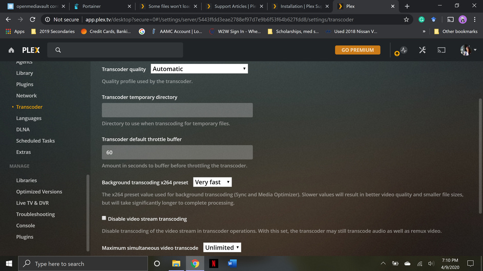

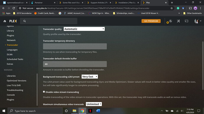

Can you check if that path is set in Settings
> Server
> Transcoder
> Transcoder temporary directory
(inside Plex; you might need to click on Show Advanced
if the setting is not visible in the Transcoder
section).

There is no path set in the transcoder.
I had previously tried setting the path, but could not get it to work (and also couldn’t tell it was actually doing anything). How would I set that to connect to the OMV/Debian path and how would I get the domain plex.direct to connect?

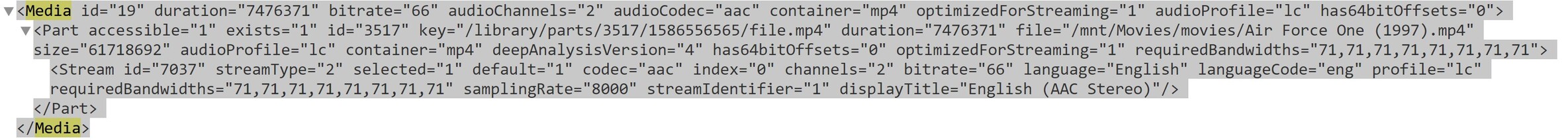

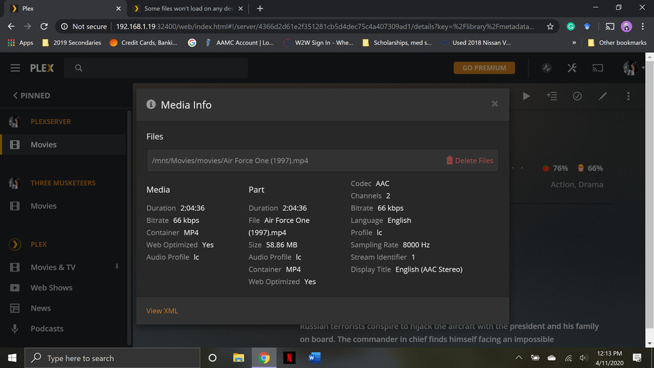

Could you pick one example that didn’t work, go to the video’s pre-play screen in Plex (details page) – click on ...
> Get Info
; this should open a dialog – click on View XML
at the bottom of that dialog. Can you copy the content between <Media>
and </Media>
to see what technical details of that file Plex got?
Ok… that at least explains why there’s no video playing… Plex doesn’t recognize it.
Does the video play properly when you play it e.g. with VLC?
The size of the file (<60 MB) implies the video part might actually be missing.
It… actually does not. On windows media player it shows frame by frame images, but not a video.
The good news is… that’s nothing that Plex broke
The bad news is, you’ll still need to identify if you just got a bad file or if something in your process is broken, leaving you with videos without actual video track
