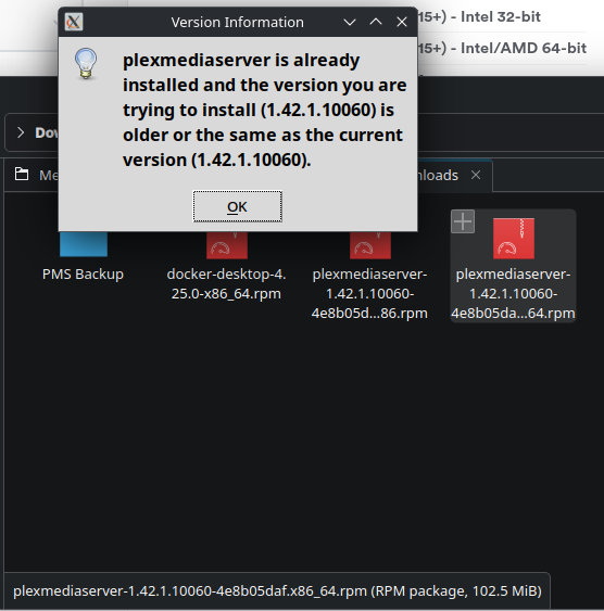

I checked the download page, and selected the 64-bit download. Upon running it, I’m greeted with a message that I have the same version of PMS installed. Would running the 64-bit installer override my current install, or should I consider backing up my configurations and database for a clean install?
You should be able to just uninstall the current version with rpm -e plexmediaserver Support Article You’re going to skip the directory removal part, obviously :grin: . Then install the 64-bit version.
That did it. Thank you very much!
