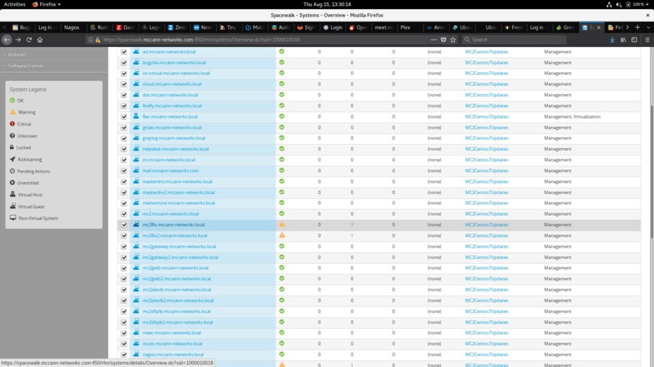

I’m running a Spacewalk server for managing updates for my 50+ Centos 7 boxes.
However, after creating a channel and adding the Plex repo it is able to find and pull the new package but does not update it. Rather it just uninstalls it.
That seems… odd. This is all behavior within the Spacewalk host & the channels therein, or in clients registered to your Spacewalk host during a ‘yum update’ process?
Thanks for the response, this happens when I try to push updates to a spacewalk client (in this case one my plex servers) from the spacewalk server. Screenshots attached.
What happens when I schedule the update is that it appears to remove the old version without issue but does not install the new version.
