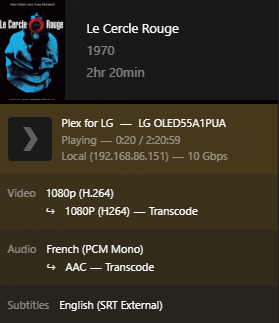

SRT subtitles on 4K LG TV still requiring transcode
Server Version#: 1.32.7.7621
Player Version#: 5.72.3 (platform 6.3.3)
For some reason my LG TV is deciding to transcode this movie even though I’m using PGR subtitles. If I had to wager a guess why it’s because it’s foreign audio and the Plex software is automatically turning on the PGR subtitles that also exist without me explicitly selecting those subtitles. This however shouldn’t happen because I have subtitle mode as “manually selected.”
So this feels like a bug in the Plex software.
As an aside: PGR subtitles SHOULD work on this TV as this LG UHD tv supports it (and the LG Plex patch notes indicate it should too), but they haven’t for many months which is why I have been going the SRT route recently. I would appreciate if the Plex devs take a serious look at subtitle support on these TVs.

It does not transcode when the subtitles are disabled. Direct play is enabled on both sides, burn subtitles is set to “never.”

I do see that the audio transcodes with the subtitles off. However, video does NOT transcode. I’m not sure I understand why PCM audio + SRT subtitles = video needs to transcode, I’d think only the PCM would need to transcode by itself?
