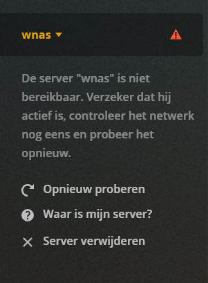

Still having issure whith my plex server on ubuntu

i cant get by the logs via the web interface
its spamming in Plex Media Server.log

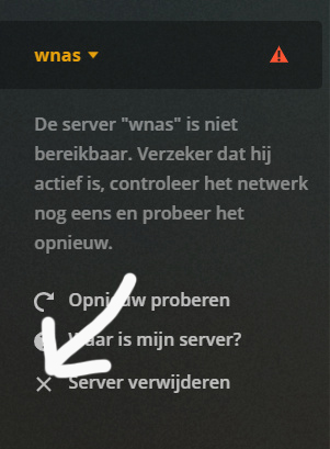

and the ping work fine to google and cloudflare only i cant ping plex.tv
it works after i deleted it out of the setting menu
it poped back in and now it works :thinking:
