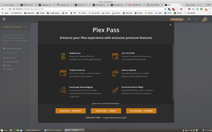

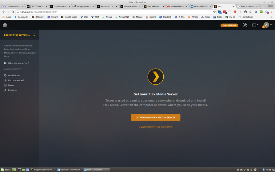

Hi Chuck
I followed steps 1-5. When the new window opens, it asks me to log in to my Plex account.
I do that, and I get this:
followed by this when I cancel the Plex pass popup:
I don’t seem to get the setup wizard at any point.
