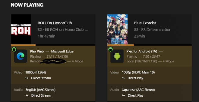

This caused the usual transcode issues, When disabling subs I get Direct play with no transcode:
After reenabling subtitles, the stream was uneffected and remained on Direct play:
Just to make sure this wasn’t a delay in transcode kicking in, I allowed the video to play in full with subs on and there was no further issues. A remote stream also started while testing the full episode playing and no further issues were seen:
