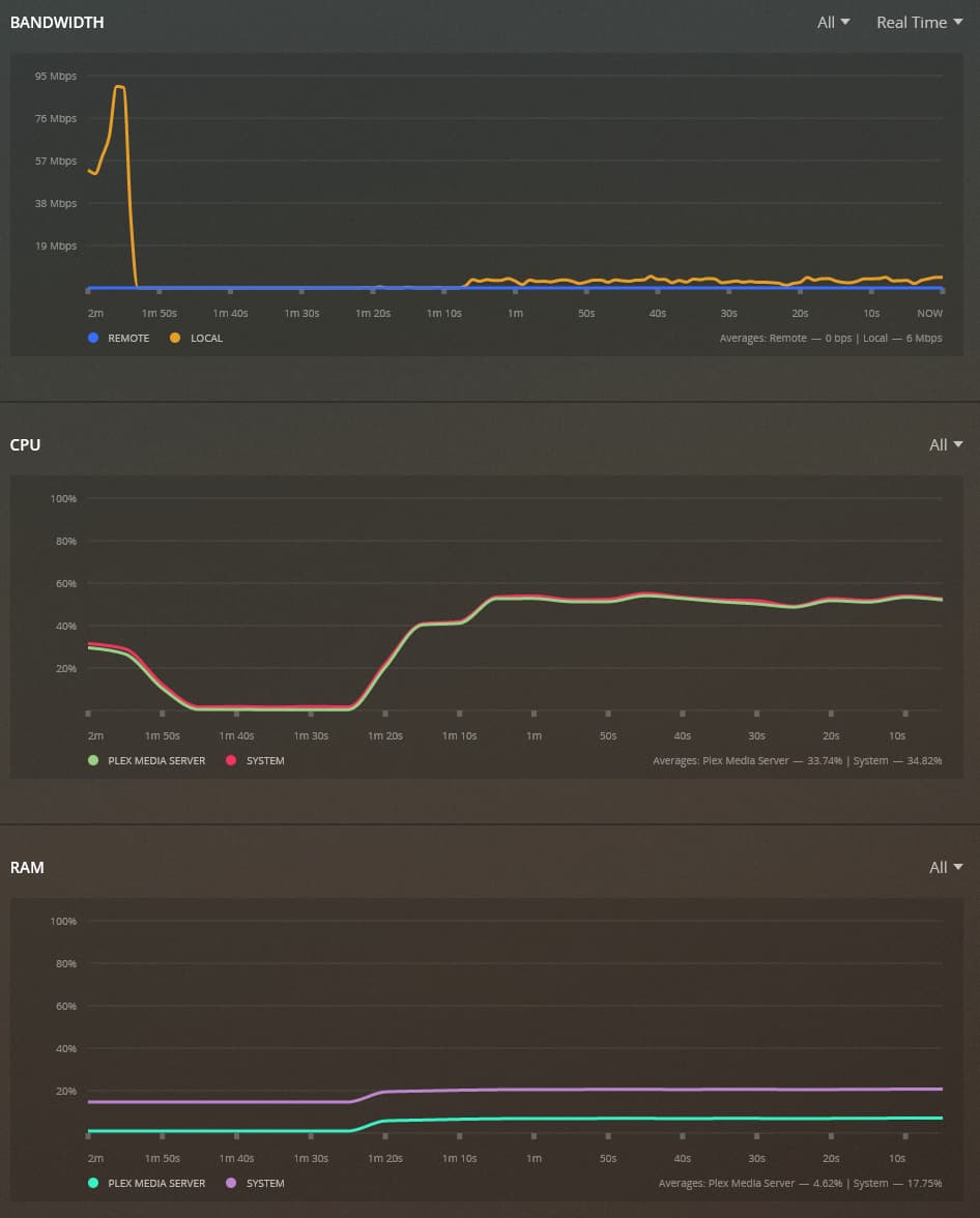

With Subtitles off, 4K content plays perfectly on 10-bit HDR 4K 60Hz TV with very low CPU usage.
Subtitles on - The only change in settings to produce this result is to enable the stream subtitles.
Notice the video stream is now “Transcode”, something I really don’t want it doing. I tried adjusting Direct Play to “Force”. Enabling subtitles overrides the “Force” setting to produce this same undesirable “Transcode” result, with stuttering and messages complaining the Server is insufficient (which I’m pretty sure it isn’t).
This subtitle caused transcoding creates PMS stuttering on an 8-core FX-8120 CPU with 16GB RAM. What is interesting is the server CPU is only at ~50% loading when this bad behavior occurs. CPU, Network, and RAM resources have plenty of margin (look at the last minute of record which is where Subtitles were turned on)
With the subtitle stream set to “None” the server settles down to a low level while playing 4K 10-bit HDR 60FPS video
I’d like subtitles to not cause video transcoding to 1080p with 4K media to a 4K destination.

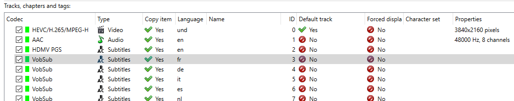

The subtitles available are part of the MKV:
I looked up HDMV PGS and what I found PGS Subtitle Won’t Appear Fix – How to Convert PGS to SRT appears to match your description of “image based”, along with a description of how to use OCR to convert image to text. I was trying to use the MKV “en” subtitle track.
With this lead, I instead looked (way) down the streams list and selected an SRT OpenSubtitles stream from a Blu-Ray source and subtitle content matched up with sound track while using very little CPU.
It appears I have new understanding and a workaround -I- can use. But this won’t keep others in the house from selecting the wrong one thereby stepping on “landmines” as I did.
The solution appears to be convert my whole collection (a large task), or request that Plex find a way (new feature) to use existing HDMV PGS information and find a low impact way to overlay this image based information onto the existing video stream. Or in the near term allow Plex to recognize and ignore (not present as a subtitle selection option) any HDMV PGS subtitle tracks.
In the interim, there is a workaround for someone who knows what’s going on under the hood. For the others, I guess other household users will be stepping on landmines like I did and bringing Plex Server performance (for any/all other viewers) to a screeching halt when they do.
I extracted one of these tracks and looked at it. It appears as binary which matches your “image-based” subtitles description
