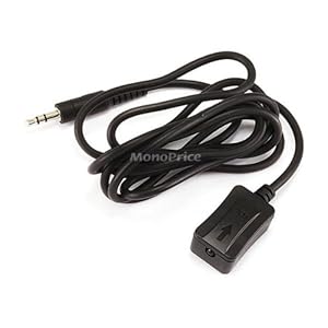

Would it be possible to use one of these instead?
http://www.amazon.com/Monoprice-5ft-Extender-Cable-Receiver/dp/B005E2XLNM/ref=sr_1_1?ie=UTF8&qid=1367551248&sr=8-1&keywords=ir+receiver
Plug it into the headphone jack and follow that walkthrough? Should still work? Or does the pin change?
Looking forward to the feedback...
No.  This monoprice receiver is not stable at 3.3V.  I actually bought this though, and simply removed internal receiver and inserted one that is stable at 3.3V and it works great.  You can also add a 3.5mm jack onto your rasplex case and keep the 3.5mm connector.
