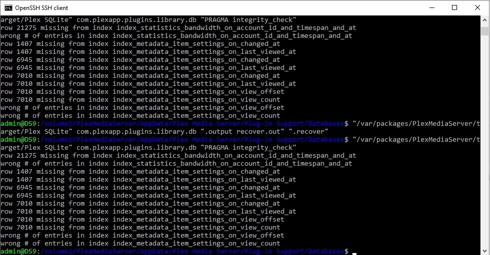

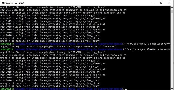

Have tried optimizing database, performing PRAGMA integrity check as well as the console recovery command, both at the 1.26.2 level AND at the 1.27.0 level, both appear to return the same results (and while the recovery process completes, it does not seem to correct whatever the issue is.
This is the output of the PRAGMA check, first on 1.26.2, then the recovery process, then another PRAGMA check on 1.27.0.5897
The relevant part of Plex Media Server.log upon installing / starting 1.27.0.x is the following:

Jun 13, 2022 18:03:55.092 [0x7f11821bc0d0] ERROR - SQLITE3:0x80000001, 779, index corruption at line 91877 of [1b256d97b5]
Jun 13, 2022 18:03:55.092 [0x7f11821bc0d0] ERROR - SQLITE3:0x80000001, 779, statement aborts at 73: [update metadata_item_settings set last_viewed_at = iif(typeof(last_viewed_at) in (‘integer’, ‘real’), last_viewed_at, strftime(‘%s’, last_viewed_at, ‘utc’)), last_skipped_at = iif(type
Jun 13, 2022 18:03:55.092 [0x7f11821bc0d0] ERROR - Exception inside transaction (inside=1) (/data/jenkins/server/3532656870/Library/DatabaseMigrations.cpp:254): sqlite3_statement_backend::loadOne: database disk image is malformed
Jun 13, 2022 18:03:55.094 [0x7f11821bc0d0] ERROR - Exception thrown during migrations, aborting: sqlite3_statement_backend::loadOne: database disk image is malformed
I’m used to SQL Server more than SQLite but if I can run a few SQL statements to correct it, I can do that; seems the issue is just some metadata indexes referring to last watched / view / etc, which I’m plenty ok with blowing out rather than nuking the entire db.

PRAGMA check only checks for errors kind of like DBCC checkdb. You would need to do the remaining steps to actually repair the database. Since it has been corrupt since 11/08/2021, not sure you will get a clean db at the end.
Some discussion on the repair process and suggestion for doing a .recover instead. Version 1.27.0.5849 - kills Media server - #30 by shiloh100

I did a recover after the first PRAGMA check, and redid the check afterwards to see if there was any difference (there was not)
