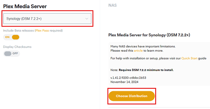

DSM 7.2.2 made some changes to the packaging requirements for Plex.
Do the following in the order given:
  1. Uninstall Plex using the first option, uninstall only! (keep all files)
  2. Reboot the NAS (Important)
  3. Go to Plex Downloads and download the package for DSM 7.2.2+
  4. Install the package you just downloaded manually in Package Center
Just remember, from now on, you need to download the latest Plex package for DSM 7.2.2+
