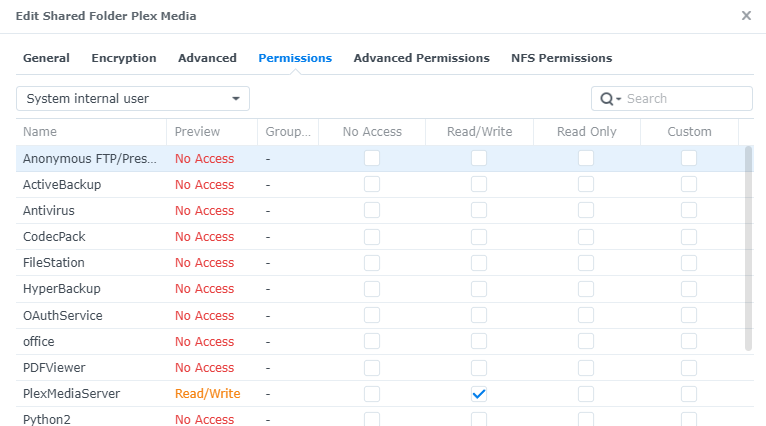

Plex see the NAS, I have claimed the server, I have enabled all the custom permissions. I have uninstalled Plex, rebooted, reinstalled, checked permissions and still
Get Unexpected error when trying to access the librarys. I am logging in using direct IP address to NAS. I have tried cleaning bundles, and optimizing libraries.
All to no avail. All I can seem to find on the web on this is all about ensuring permissions are set correctly.
Any other thoughts?
Where are your Plex media files? I have a shared folder called Plex Media at the root of Volume1. Inside there I have all my folders for movies, kids movies, tv shows, music, photos, etc in there. This is the only permission I needed to make on the Plex media folder with the System internal user for plexmediaserver, then I added my folders and files which inheiret the permissions and created the libraries in plex.

All have System User custom setup as recommended.
