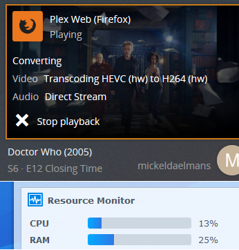

not at home, but I just remote-played a 8bit HVEC (Bitrate 1736 kbps, 1080p, AAC audio) file with ext. SRT subs through Plex Web from my DS916+.
CPU hovers around 10% to 20% (but it is also running some scans in the background at the moment). PMS indicated that its doing a HW decode and a HW transcode.
