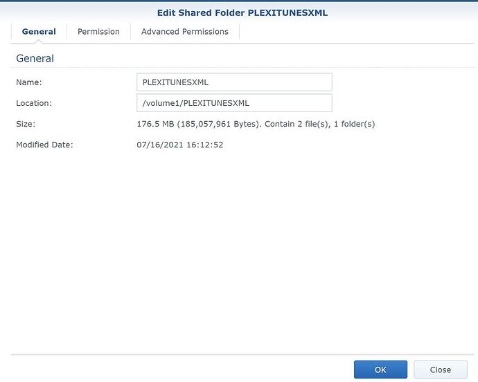

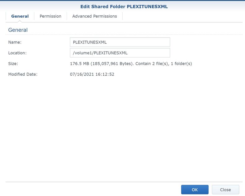

For those seeking more information, here is what worked for me, I hope it helps in some way. One thing I will add - you may get an error message when importing. Before attempting to import again, go see if your playlists are imported. Mine were, but, I had imported TWICE (thinking I made mistake) so I had to go and delete all of the duplicate playlists.
Ah, and another caveat. I learned that playlists cannot be in FOLDERS IN itunes. In other words, within the Itunes application, you should NOT nest/organize your playlists in folders as I did (1980s /U2 Favorites). Plex (currently doesn’t seem to recognize these in the Itunes XML file it generates that you will be altering.
I was unable to find this exact file version. I did download two updates on Friday after reading this forum and your post but neither were this exact version. The closest one I had was Version 1.23.6.4881.

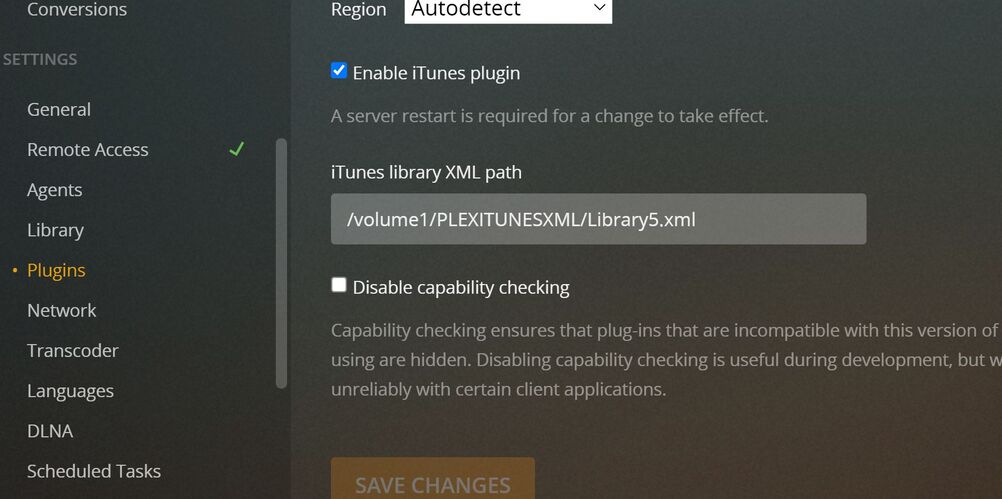

I manually installed that update on my Synology for Plex and then also put a new location in for my XML file on the Synology which for me is:
/volume1/iTunesXML/iTunes Library.xml
This folder is outside of where the music files reside.
After updating that in Plex, I saved it. I then restarted my NAS. I opened Plex again but all I am seeing when I click the three dots next to playlist is “Pin”. There is no “import iTunes playlist” option.
