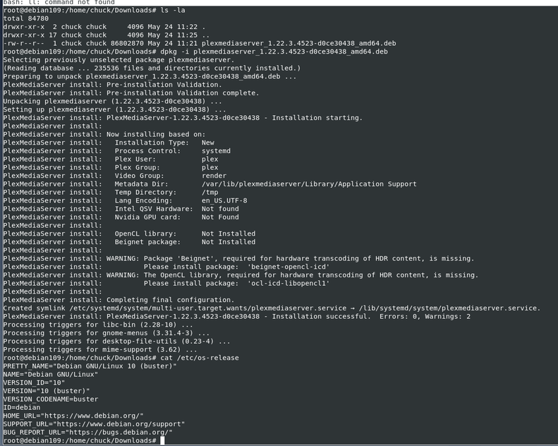

VM created
  1. Created Debian 10.10 VM
  2. Installed PMS (Public release)
  1. Configured server
  2. Installed override and upgraded
Please tell me what I’m missing.
I think we figured it out and it’s completely my fault. plex:plex exists but I had a broken symlink in place of /var/lib/plexmediaserver.
Removed the symlink, created the home directory and and made plex:plex owner.
