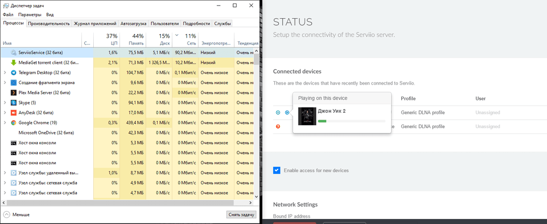

Perhaps I misunderstood you. But in the Servio application, the John Wick 2 movie support direct play without transcoding with the original bitrate in a standard player. Could the problem be with the Plex app itself? I attach Servio screenshots and Servio loads to PC.

Thank you for answer. Servio - just DLNA server in Windows. And Servio don’t have app, like Plex on Samsung Tizen OS. I use native Samsung video player, when watching film John Wick 2 with Servio (without transcoding and buffering).
The DLNA player on the TV is not the built in player. By built in I mean built into the TV’s OS. The DLNA player is a special program written by the TV manufacturer and can usually do a lot more than what the OS is capable of.
