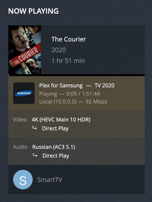

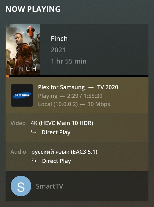

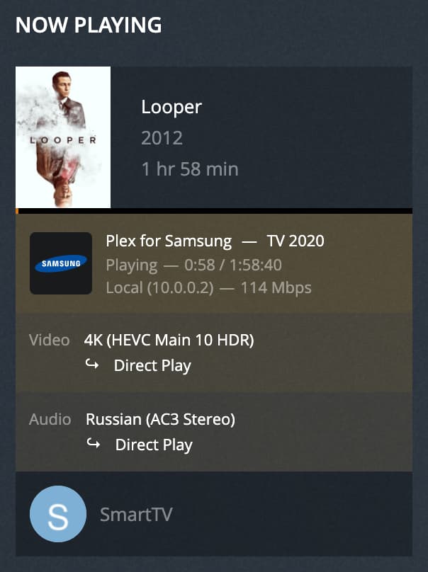

The screenshots below demonstrate that some 2 movies use Direct Play and one is being transcoded. In all cases, the Original quality is selected in the player. And all 3 show HEVC Main 10 HDR. The Courier is transcoded when playing on the TV but when I tried this same movie on iPhone or Plex for Mac they both used Direct Play. So it’s either something in the video that my TV doesn’t support, which I can’ figure out myself or there’s a bug in Plex for Smart TV.

Finch uses EAC3 and is played directly, which means the TV does support EAC3, while The Courier, which causes the problem, uses AC3, same as IT, which is played directly, which means the TV does support AC3 as well.
And my problem isn’t with the audio but with the video transcoding. All 3 movies show HEVC Main 10 HDR but 2 of them are being played directly while The Courier is transcoded, which makes me wonder what’s wrong.
