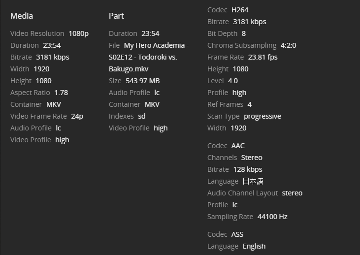

Media Info

I did a bit of analysis on one of the videos that were halting and noticed that there were differences in duration reported for the video. MediaInfo was showing the duration of the MKV at 23mn 54s, but when I was looking at the actual tracks, the video and audio tracks weren’t that long, they were shorter by about 4 seconds… it was the subtitle track that was longer. There were two extra empty lines in the SSA file that I removed, but it still failed to end playback at the end of the video.
I’ve put the subtitle file back the exact way it was. Right now this file is an MP4 with an external SubStation Alpha subtitle file and the vast majority of the time it halts within the last second of the video. There is a rare occurrence where it will continue on, but otherwise, it just sits there ‘buffering’. Please note that I had Use hardware acceleration when available disabled during these tests.
