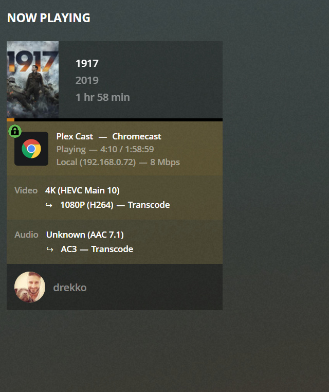

here is what its doing:
so its transcoding 4k to 1080 ( 1080p TV) ( btw only reason i downloaded 4k is because I plan to buy a 4k tv soon, so thought id start collecting 4k)

Seriously, if you do not have a 4K TV do not play 4K material.
Your system is not capable of transcoding 4K. Without a Plex Pass, your system can handle one 1080p transcode, not including the load of the CCTV system.
The AAC 7.1 audio may also be an issue. Choose an audio format that does not transcode.
Ideally you want both video and audio to direct play.

Get an Apple TV 4K. It will Direct play your 4K files @1080p and tonemap them for you if they are HDR.
