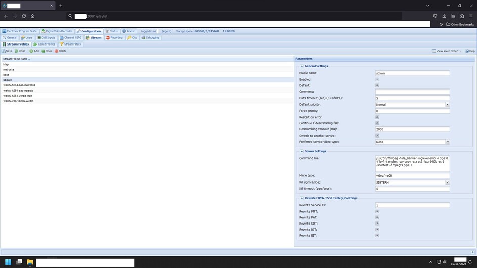

Switch to another service needs to be enabled in the stream profile being used by the user for this to even work and you need more than one service assigned to a channel. It is failover verbatim.
You need to set the data timeout in the stream profile because TVheadend needs to know how long to wait until it decides a stream is dead and proceeds to switch service.

Show me a screenshot of your stream profile and make sure the stream profile you’re using is set as the default.

Change SIGTERM to SIGKILL and try that. That’s the only thing different in mine.

With a timeout of zero in the ‘stream profile’ you are using, TVH will hold the service open endlessly with no data, and it won’t try another service. With a timeout set in the stream profile, TVH has tried another service 1 time out of probably 100 tests.
Just set the timeout to 5 seconds and killall -9 ffmpeg in the terminal will make it switch. If you hover over ‘switch to another service’ it literally says what it does and if it’s worked before then it’s correct. The channels need more than one service assigned. If you see it keep trying the same service over and over again that’s because TVheadend tries services in a predetermined order and Plex is resetting the connection which makes it start over which is why I modded it to randomly select one. I also modded some timeouts in the source code to get it working stable. Use my mod.
