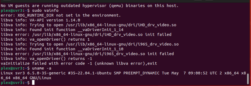

You guys should test with an ARC. I think you’ll be surprised, or is something happening by accident. I think you might actually install the drivers. I had boot ssd fail on one system, so refreshing my system. Loaded up fresh 22.04.4lts. Did not manually add the intel repositories. Drop the plexinc docker on, and all gpu functions work, all the way upto av1 transcode.
Vainfo was not even installed on this machine, I just installed it for this output with multiple errors.
Combinational hevc and av1 transcode is super great even on an 7-8year old potato cpu.
@Menel
The docker image doesn’t install anything on the host. Docker doesn’t work that way. Everything needed for the container to run is INSIDE the image.
There will not be any visible capability outside the container as you’re showing in your screenshots.
Must have been something either Ubuntu is now including or some other package you tried.
What I was thinking, is you install the driver inside of the docker?
No. Drivers are installed on the base host. At most, client runtimes are installed in the container. With Docker, you don’t install anything. You only need pass /dev/dri through to the container.
In the case of the ARC GPU card, Plex uses it through the VA API if supporting card drivers are installed on the host.
