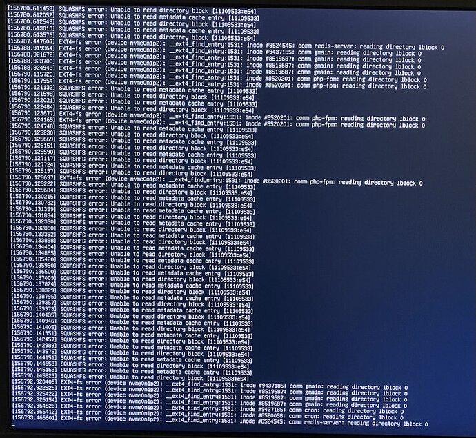

After 1-2 days, SSH stopped working and these show up:
Note that this is the third time I try to set up my server. I even ordered new SSD and HDD components for it, thinking that they’re broken. I initially thought that it’s caused by Home Assistant, but I didn’t install it this time. I have no idea why this happens on a fresh machine (the NUC was newly purchased), on a fresh Ubuntu Server installation with default settings (a widely used distribution), and a fresh Plex installation.
Does anybody know how to fix these errors?
It’s trying to install on the Live installer SquashFS.
You install on the main system installation & reboot.
Could you please be more explicit? Do you mean that sudo apt install plexmediaserver is incorrect?

It looks like you’re installing Plex ON the flash drive.
SquashFS is used by the boot ramdisk and the Ubuntu Installer USB

No, I’m not installing on the flash drive, I’m installing on the SSD.

Could it be related to this maybe?
No.
Looking up the error codes – there is/was major corruption at that point.
It wanted to read from block 0 – where no application data exists so therefore the filesystem clearly exhibited corruption.
