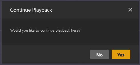

As the title suggests, I am unable to cast anything to either of my RasPlex clients.
I play something in Plex/Web, then I select one of the RasPlex clients
Screenshot 2023-09-27 065343
and it immediately pops up a dialogue asking if I would like to continue playback in Plex/Web or not.
Screenshot 2023-09-27 065209
I click on No, but nothing happens and nothing is sent to RasPlex at all. If I click on Yes, then playback continues in Plex/Web.
Anyone else experiencing this issue?
Anyway to resolve the issue?
Any help would be appreciated :slight_smile:
Rasplex was based on “Plex Home Theater”. This has been deprecated and left unsupported for years now.
I think development of the rest of Plex has now reached a point where its no longer compatible with such an old client codebase.
IMHO, your best course of action is switching to LibreElec and the Plex4Kodi plugin by @panni : PlexMod for Kodi (18, 19, 20, 21)

They may require a running Plex server to be present in their local network neighbourhood, to act as a Companion Relay. Whereas PHT didn’t.
It has to do with opening a port on the device and listening for requests, which is not allowed on those tightly locked-down platforms like FireTV.
You may be right Otto.
I searched for any settings on the Fire TV and in Plex on the Fire TV, but I did not find anything that might have helped.
That’s a shame since I used to use ‘cast to’ when I could not easily find or decide what I wanted to watch.
It’s not a big issue, but it would be nice if it still worked … lol
