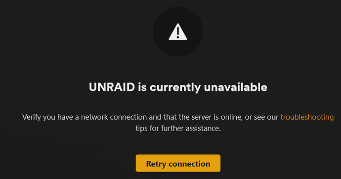

Server Version#:
I have bo idea what happened. I updated my docker container and now its dead
Server Version#:
In my log file it looks like the sql database is corrupted. Im going to guess noone has a solution and im going to have to blow away the docker and start over. Ive had a few apps do that lately. Ill wait until someone responds though incase theres a better way to fix it that diesnt lose all my settings.
