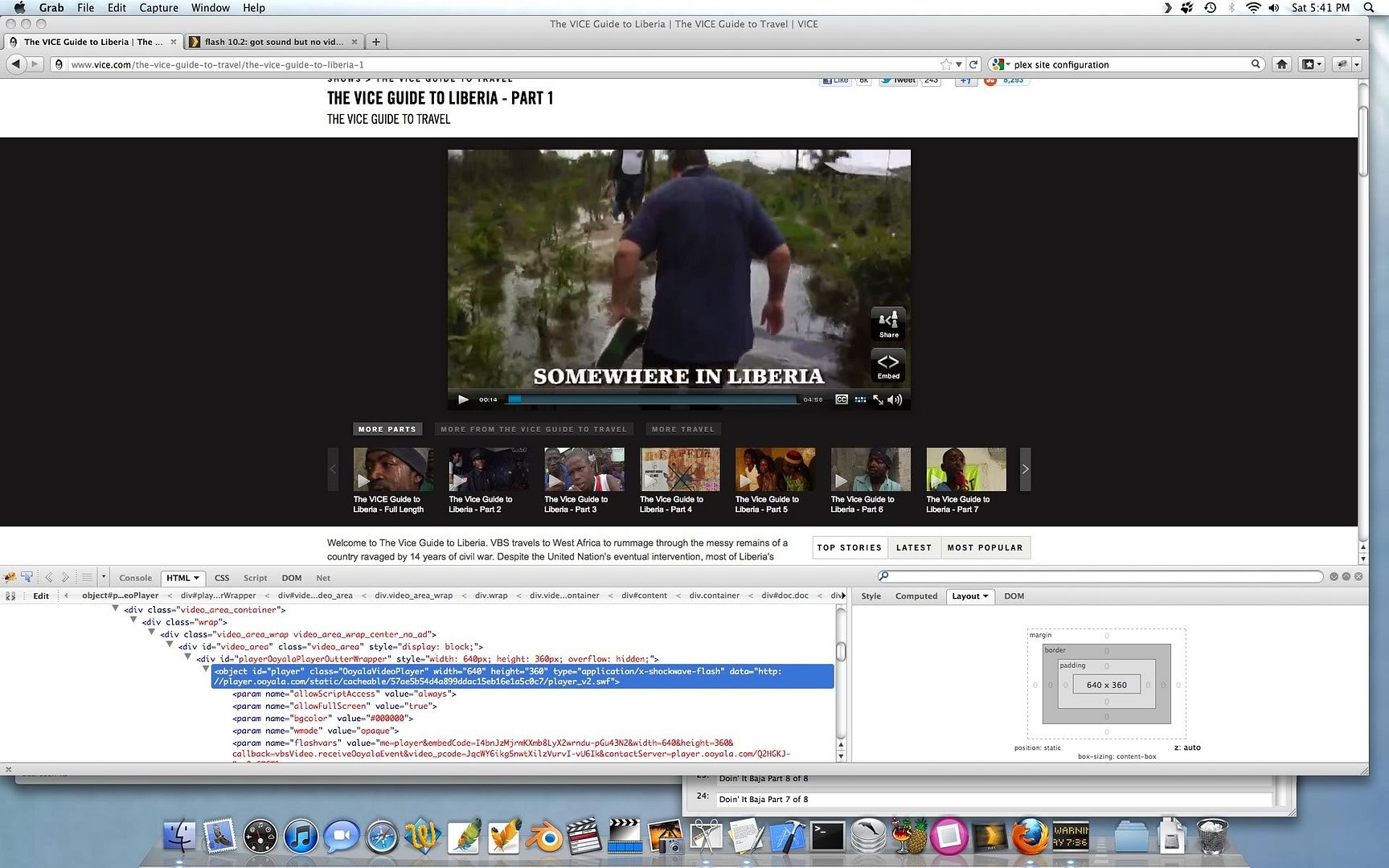

heres a screen grab of the player details from firebug
might have to click to make it larger. but so Im stumped at the moment, I dont know where else to look for the swf player details. any help would be great.

Reading and reading and reading it seems that the framework isnt going to work to grab the player data, and I cant seem to figure out how to make it do that.
I might have to abandon this plugin, sucks
