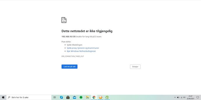

This is what it looks like for me now .. :
Use the IP address of the device itself.
Either I must have the wrong IP address for the device or that doesn’t work for me either.
This is the screen I get:
Nevermind. Turns out I had the wrong IP address for the server. Found it now and am able to update like normal.
