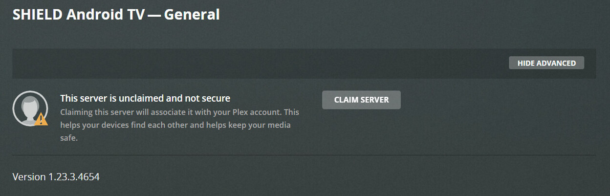

Here is my unclaimed Shield.
I can create a new library from the sidebar or from the library settings tab.
