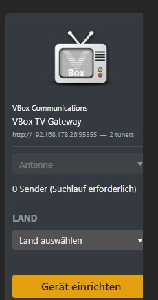

How can i use VBox in Plex? There is shown only Antenna, but i want to search for cable channels.

I own this:
VBox XTi-3452 (DVB-C)
It is supported, but the button, regarding to switch between Antenna and Cable, there is no option, to switch to cable.

Screenshot 2024-06-27 221539
I want to search cable channels. But i can´t change the entry for Cable. There is only Antenna written. With VLC, i get a Stream, at also Kodi, but not in Plex. I prefer Plex. I am not interested in other Player.
