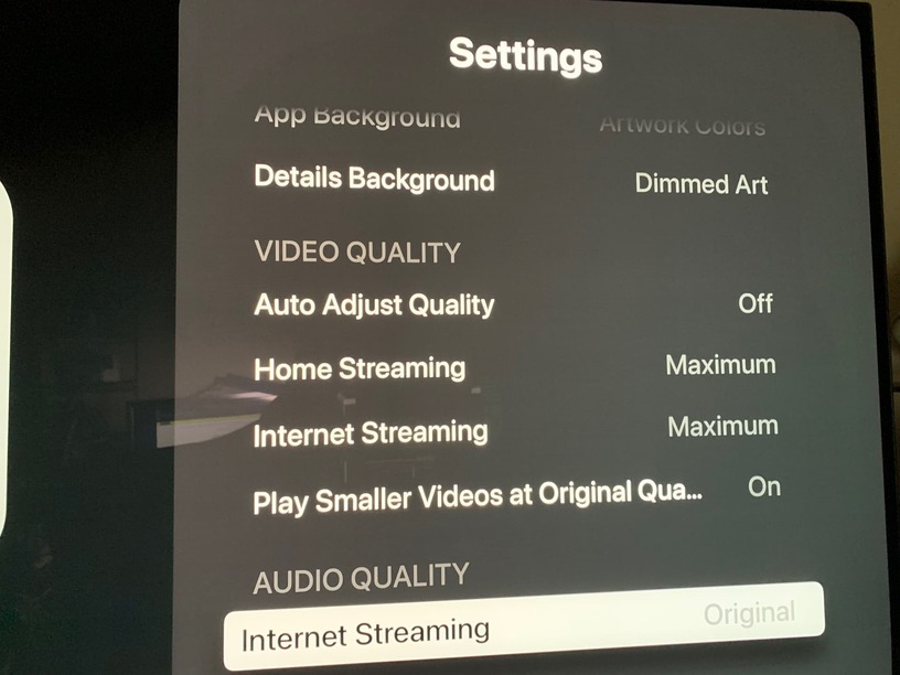

tvOS 15.6. Streaming all set same as yours - auto adjust off, home/internet streaming to max and audio original.
