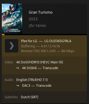

Video also transcoded while only audio needs to be transcoded
Server Version#: 1.32.7.7621
Player Version#: 5.71.1 (platform: 6.3.3)
The player on my LG TV unfortunately does not support TrueHD audio playback. It makes sense to me for Plex transcoding the audio to something that is supported (EAC3 in my case). However, Plex does not only transcode the audio, it also transcodes the video in this case.

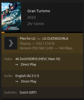

When I then select the AC3 audio track that is included in the video file, both video and audio are direct play. When I disable the subtitle (srt in this case), but leave TrueHD on, the video is direct play and only the audio is transcoded.
This behavior is not what I expected. The hardware I run Plex on does not have hardware encoding available, so transcoding 4K video makes playback impossible due to all the interruptions. How can I make sure only the audio gets transcoded with subtitles on and the video remains direct play? For this specific playback it is not an issue because I can select a different audio track with the right codec, but sometimes TrueHD is all that is included in which case the video becomes unplayable for me.
See the screenshots below to see what I mean:
2023-11-07_10-44
2023-11-07_10-45
2023-11-07_10-53
You are running into the limitations of the Plex LG app and the limitations of your server hardware.

When an unsupported audio format is selected, Plex will transcode it to a supported format.
With the Plex LG app, when the media is direct streaming, such as when audio is transcoding, enabling any type of subtitle results in a video transcode. The subtitles are burned into the video, becoming part of the video stream.
Plex must do this due to a limitation in the streaming protocol used between the TV and the server. If Plex sent them as a separate track, they would become out of sync with the audio and video tracks.
Note that subtitle burning uses the CPU, even if the video is transcoded using hardware acceleration. The burning process is single threaded, unable to take advantage of multiple cores.
As a result, lower power CPUs and those with slower cores will struggle to burn subtitles.
CPUs such as the Celeron J3xxx will struggle to burn subtitles into 1080p media. Recent Intel Core CPUs can burn subtitles into 1080p media. I’m not sure if any CPU can burn subtitles into 4K media, given the number of pixels that must be processed for each video frame.
