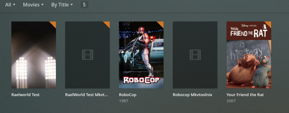

Curiously, this is what I get which shows yet another apparent contradiction.
ps: Yes, that’s my 11 minute test file in that library.
I like rats.
Plex’s bitrate estimates for files truncated by dd can be really nuts, when it goes off of the file header vs. the stream itself. I think it gets better once deep analysis processes the file, but I haven’t dug into it…
301 kbps, lol.
But that said, I can Direct Stream both of the original test files immediately after adding them, even in a web browser.

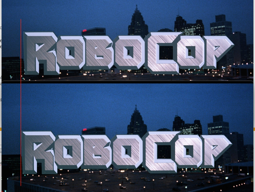

The ChuckPa-Test.mkv source is also matted differently on disc.
The Robocop logo zooms in on screen and then stays for a few seconds. The horizontal alignment is different between the two.
The color/contrast/detail is also different between them.
This just shows that it’s a different retail Robocop disc. So sadly it doesn’t demonstrate much.
Edit: Actually it demonstrates how much better the newer release is. It has significantly more detail and is less noisy. :slight_smile:

if the source encodes are different (different masters/mastering), then the results of rip can’t really be compared equally.
