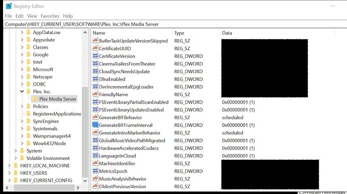

Hi, I’m trying to set GenerateBIFFrameInterval on regedit (because I use it on Windows) follow this document. But it’s still not change. All new media files still generate thumbnails at default intervals not the new interval that I set on regedit.
Did anyone know why? and how to solve this?
Share a screenshot of Regedit and the full path and key and type and value you’ve created?
Regedit makes it all too easy to do sliiiightly the wrong thing.
This is my config
I set it to 1 because I want to generate thumbnails every second since my media is only short videos 5-10 minutes.
Note: Actually, this key (GenerateBIFKeyframesOnly) is not presented on the regedit at the first place. I just add it by myself.
This is an informed guess -
Most media won’t have keyframes that close together.
So if you want a VERY short interval you may also need to set GenerateBIFKeyframesOnly to 0.
Let us know if that helps.

Hi, Thank you for your help.
After running the schedule job last night I found that no matter how I set GenerateBIFKeyframesOnly is 0 or 1, whatever, it will already generate BIF with an interval of 1 second. It’s been working since I set it up. GenerateBIFFrameInterval to 1. But I can’t see it on Plex Apple TV because when I scrub a thumbnail it shows a preview every 10 seconds but when I scrub on the web it shows every second. So, I think this might be a limitation of Plex app on the Apple TV. That’s why I raised the issue because I was mistaken it wasn’t working until I found this on Plex Web.
Different apps have a different minimum scroll/seek distance. Setting a smaller GenerateBIFFrameInterval than the app minimum scroll/seek distance won’t change the app behavior.
I thought the Apple TV interval was smaller, though.
Yes, I agree. And that’s will make thumbnail quite useless on some platform :smiling_face_with_tear:
