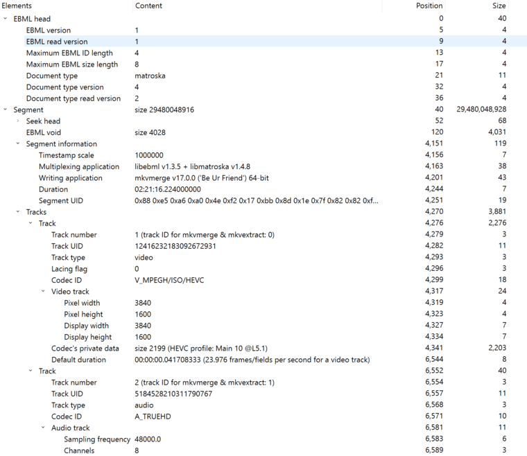

Also, here is the video info from MKVToolNix prior to the re-encode:
