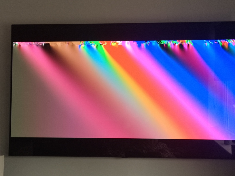

Here is some samples of the glitching

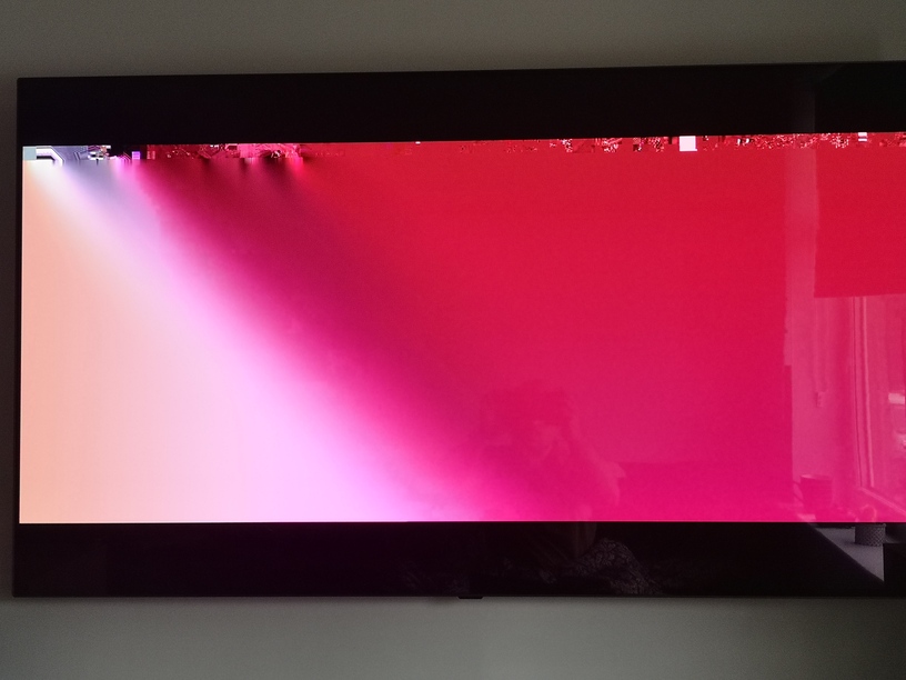

I’m also seeing issues with Thor Ragnarok. When TrueHD selected, I see a rectangle of corrupt video in upper left corner of screen. When dts or AC3 audio selected, the video plays normally.

Further more after alot of research I have been able to turn off transcoding. I am only using my plex server for viewing my 4k material at home. And it works just fine when I play the same movie via the Nvidia Shield (2017), but I notice the picture is much better and more detailed via the internal plex app on the TV then via the shield. But I have these glitches like other people on this thread every few seconds.

Unchecking ‘DTS’ from the supported audio formats in the plex app causes the Plex Media Server to helpfully try to transcode the audio, which results in these exact graphical glitches as pictured at the top of this thread from about the ten second mark in any video. Interestingly the audio works perfectly, but the picture is just colors and glitches.

  • 4k videos with HDR and unsupported audio codecs glitch the video stream after 10 seconds of playback. Weirdly, the audio continues to play just fine, but the picture turns into a rainbow palette for the rest of the video.

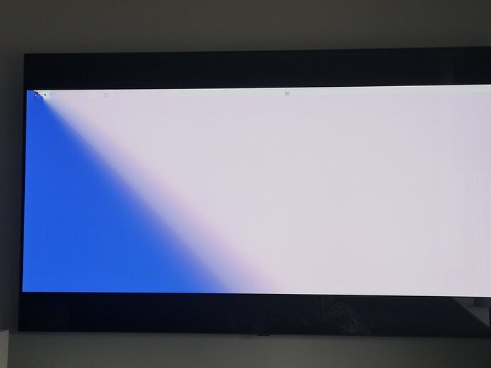

I’m new to Plex and encountered this issue immediately on my LG B7. When TrueHd track is selected, the video just turns to a solid colour with a square of scrambled video in the top left corner. The issue is resolved when switching to AC3 5.1 track.
