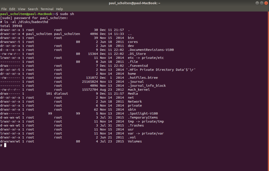

I’ve been reading your posts this weekend trying to get my external hard drives to play nicely with plex. I have to external HDs, one of which is working well, but the other is formatted differently and I’m having difficulty getting plex to see subfolders. I have reached the point of mounting it in the folder “disks” as outlined in your tutorial and at this point I think the issue has to do with permissions but I can’t quite seem to figure it out. I’m brand new to linux and I’m hoping for help. Please see below for output from ls -al for the mounted hd called ‘badexthd’. Any help would be much appreciated. Thanks!
PS the folder I need access to is Media

So that is the article I’ve been following to try to get this set up. I went back and unmounted the drive and ran
chown -R paul_scholten:paul_scholten /disks
then ran
find /disks/badexthd -type d -exec chmod 755 {} ;
find /disks/badexthd -type f -exec chmod 644 {} ;
then mounted the drive and ran these 3 again. Clearly I’m missing something or not fully understanding as after going through all that (which actually took a fair bit of time to complete) I went back to PMS and can get to /disks/badexthd/Media but there are no visible folders inside the folder “Media”
Also, I’m not sure if it matters, but after every line of output from running the permissions it reads :Read-only file system
Thank you for the help and please let me know if you have any additional ideas. I’m reaching the point of reformatting the drive to a more straight forward format.
Thanks!

#Mount Bad Ext Drive (hfsplus) at /disks/badexthd for Plex
UUID=55beffd3-9b19-3e2a-85db-8d35bb13a956 /disks/badexthd hfsplus defaults,auto,rw,nofail 0 0
Also, since this is an hfsplus volume, you need to add “force” to your mount options:
UUID=55beffd3-9b19-3e2a-85db-8d35bb13a956 /disks/badexthd hfsplus defaults,auto,force,rw,nofail 0 0

Here is output
/dev/sdc2 on /disks/badexthd type hfsplus
(ro,relatime,umask=22,uid=0,gid=0,nls=utf8)
I’m sorry for being so clueless, but now how to a fix that. i tried unmounting and remounting but this wasn’t successful
