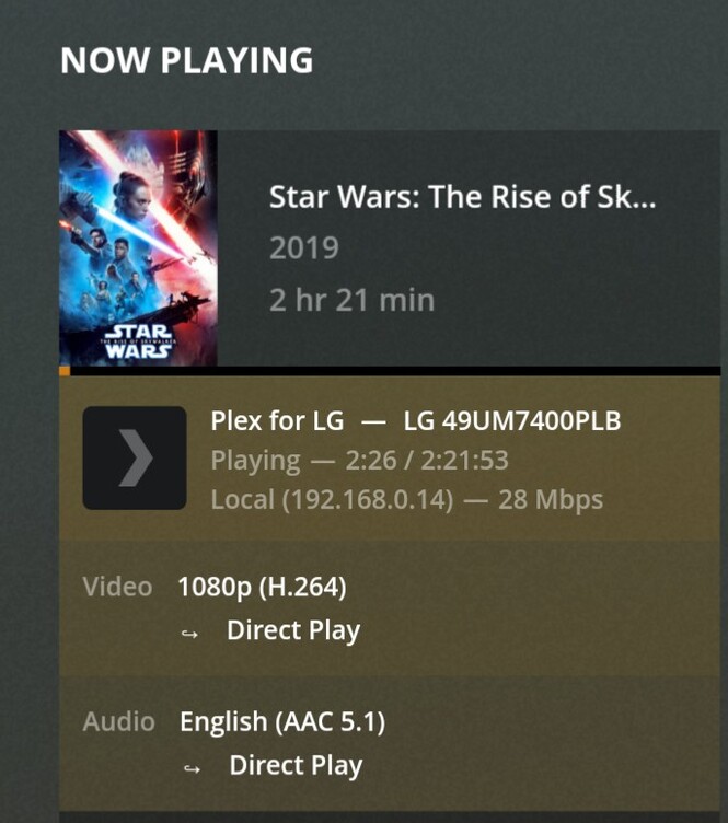

Just tried it and it says AAC5.1 Direct play.
That’s one piece of the puzzle solved as that means the TV is converting AAC5.1 to AC3 5.1 after it leaves PLEX.
So what I am looking for in a new TV is one that also supports AAC5.1 but also eARC, and the ability to output PCM 5.1
I think I’m going to have quite a hard time finding an answer to that though!
