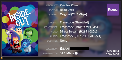

That is interesting! I have the Roku Ultra (4660X) connected directly to a compatible receiver via HDMI. In fact, it’s literally the same HDMI port where I had the Shield connected which handled lossless audio fine. I have essentially the same settings as you (except a direct connection instead of eARC) and it still forces a transcode. Puzzling.

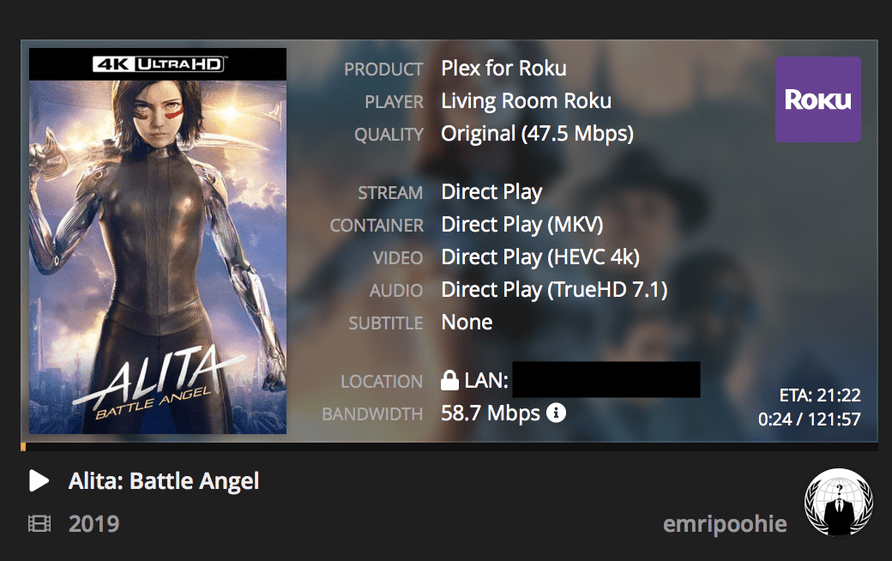

Just did another test just to triple check that it’s actually playing TrueHD and it is, see below:

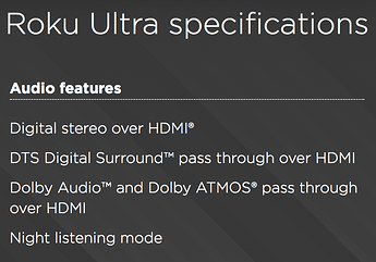

Roku’s site also confirms that it has DTS and Atmos passthrough capabilities, thus the reason why I upgraded from a Roku 3 to the Roku Ultra:

@Cafe_Diem - What does yours transcode to when you play the file? Are you using Tautulli, if so, do you mind posting a pic, might be helpful for staff like Achilles to see if they can replicate.

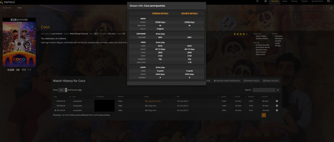

I do! Here’s a screenshot for DTS MA, and one for TrueHD.
DTS-MA
TrueHD
I have a 2018 Yamaha Aventage so it handles basically everything without a hitch. No problems with direct-playing TrueHD and DTS MA.

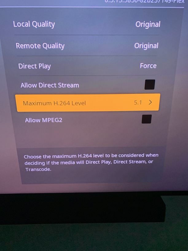

Ahh you might have direct stream enabled. Can you confirm your Plex video settings on the Roku show the following?
I’ve been fooling around with those settings and have seen all kinds of quirkiness.
If I set it to force, Direct Stream doesn’t seem to matter. However, DTS-HA MA seems to be playing on the receiver as DTS core, which still leaves Tautulli showing “Direct Play” of the whole DCA 7.1 track.
