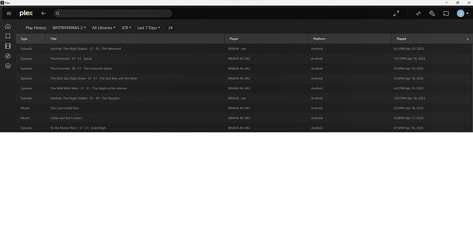

This was the account it was on when this happened…
4:34 was the time, the Bravia 4K…
Shows it’s pulling from my libraries…I click the linked file and get…

The episode displayed as the guilty party is S01E01
And what brings you to this conclusion?
I’m not sure what you think these images prove but I don’t think they prove anything. The first image shows that that Dick Van Dyke episode was played but it in no way showed where it was played from (Plex ad-supported stream or local video with no ads).
The second image shows a similarly named video in your library but it doesn’t show that it was the one that was played.
IOW it doesn’t follow from those images - there’s not enough info.
Another way to try to prove this might be to play the video with the ads. Stop the video. Go into your library and rename that file or move it to someplace outside of Plex’s reach. Then go back and attempt to play the video with ads. If it plays then you just verified that Plex is not playing your local file anymore because it ain’t there!
The listing of videos played are hot-links. I select the video link and it takes me to the episode IN MY LIBRARY.
The last picture is the file path for that file…and it clearly shows it IS in my library. ![]()
