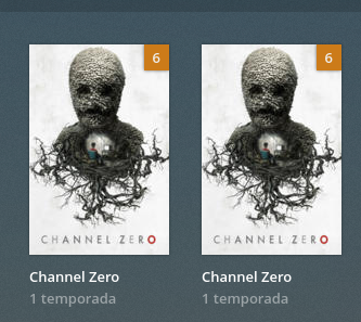

But Plex Media Server shows them separately:
And the advanced settings of this Plex section are:
Why are seasons in the same series not shown under the same cover?

ok, I’ve renamed the folders/files as follows:
/multimedia/Transmission/series/Channel Zero s02
├── Channel Zero s02e01.mkv
├── Channel Zero s02e02.mkv
├── Channel Zero s02e03.mkv
├── Channel Zero s02e04.mkv
├── Channel Zero s02e05.mkv
└── Channel Zero s02e06.mkv
/multimedia/Transmission/series/Channel Zero s03
├── Channel Zero s03e01.mkv
├── Channel Zero s03e02.mkv
├── Channel Zero s03e03.mkv
├── Channel Zero s03e04.mkv
├── Channel Zero s03e05.mkv
└── Channel Zero s03e06.mkv
Now it works.
