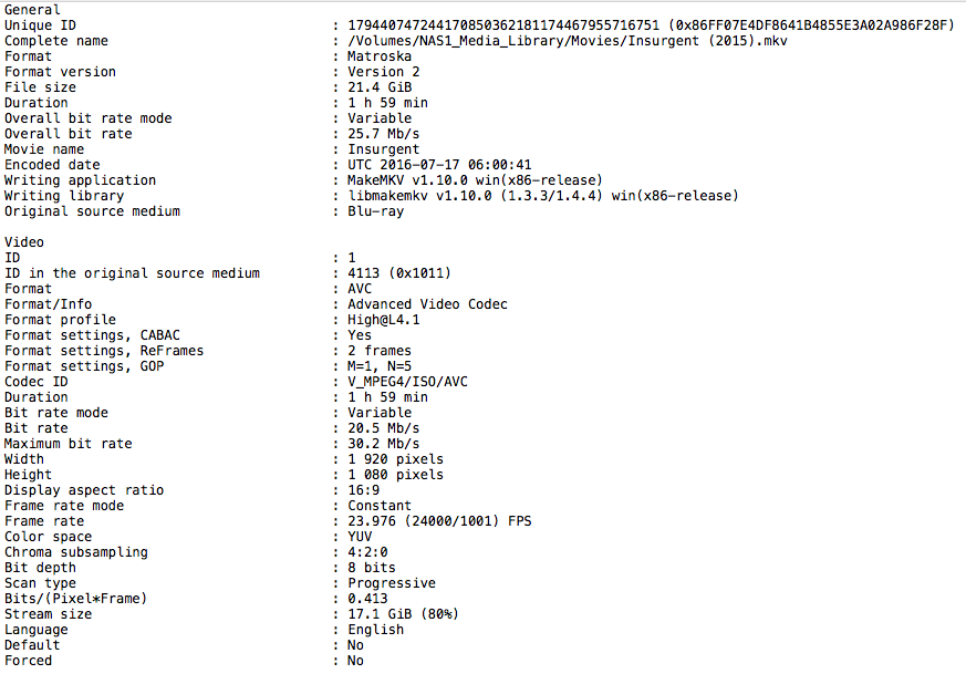

This movie wants to transcode when it plays:-
Whereas this one plays direct-
Both are .MKV, both are AVC (H.264) albeit with different header information. So is that what trips the server up??
