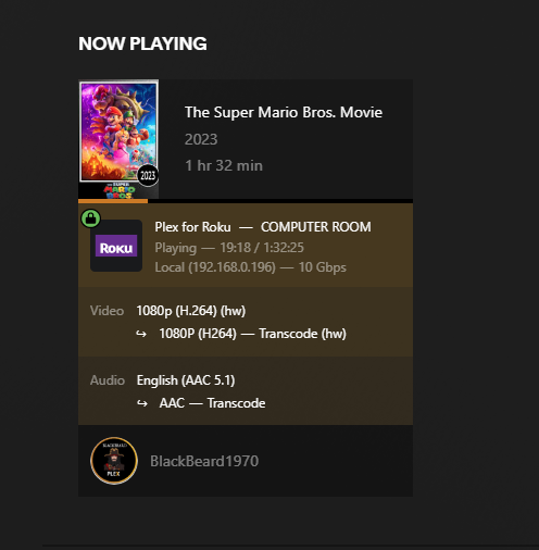

Why is 1080p h264 transcoding to 1080p?
Synology DS1520. plex server: Version 1.32.1.6999. Using Roku Ultra
Why is the video of 1080p h264 transcoding to 1080p ? and loading very slow.
Logs included..
Plex Media Server Logs_2023-05-16_12-08-55.zip (4.6 MB)
UPDATE:
i noticed that direct stream was UNCHECKED..hmmmm and DIRECT PLAY is auto..
..but still loading very slow

May 16, 2023 12:04:51.708 [139859440401208] DEBUG - [Req#322653/Transcode] MDE: Cannot direct stream video stream due to profile or setting limitations
Plex decided that the audio has to be transcoded because 5.1 isn’t supported (“audio.channels limitation applies: 6 > 2”), and since you had direct streaming disabled, Plex couldn’t just repackage the original video together with the transcoded audio, so transcoded the video as well.
Can’t speak to why things are still slow with direct stream though, since that NAS shouldn’t have any problems transcoding a single AAC track.

Capture3
so then i am assuming that this is a Roku Ultra issue.
I can’t speak to why it’s taking so long to load, but it can’t be direct played because the audio is transcoding. Direct play is only possible if everything (container/video/audio/subtitles) can be played directly. Direct stream happens when at least one thing can’t be played directly, but others can. In your case, the audio can’t play directly, but the video can, so Plex copies the video stream as-is (i.e. no quality loss) into a new container, which is then sent to the client.
There’s more information in this support article: Streaming Media: Direct Play and Direct Stream | Plex Support
It’s reporting DirectPlay (if you take the screenshot too quickly)
but is really settling to be Transcode

The activity will always initially report as DirectPlay.
It tries that first unless it’s an absolute MUST TRANSCODE.
As soon as the video starts, you’ll see reality in the status.

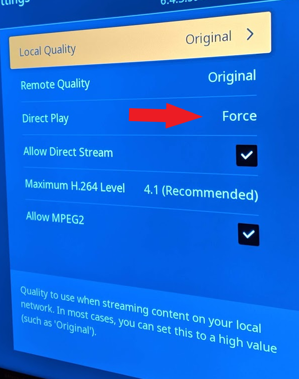

I don’t know if your Roku is the same as mine but I had to change a few things to get rid of the “Direct Stream” and audio transcoding. I believe this was an audio sync problem with mkv files. I don’t think that issue exists anymore but this setting is still checked by default
In the settings I unchecked the box that says AAC stutter workaround here
I also changed direct play to force instead of auto. I don’t really have any media that needs transcoding on that TV so that may not be the best setting for everybody
Everything I’ve tried since then, from h.264 SD to h.265 Main 10 direct plays now
