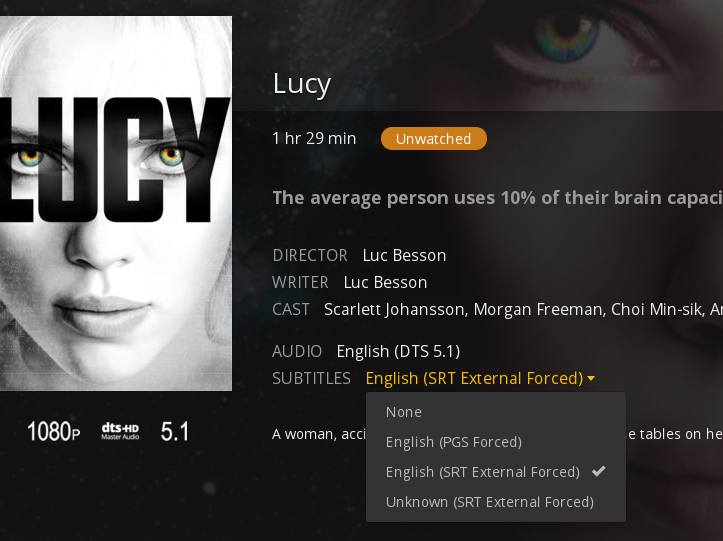

I have tested use of a non-tagged subtitle. Plex sees the ‘Unknown’ subtitle but will not play it by default in my case because English is my default language and there is an internal english subtitle track. (see attached). This isn’t a proper example. See below. As you can see, I can manually select the unknown track.
I do know Plex/Web, Plex/Roku, Plex for Samsung, and Plex/iOS will pick up the forced subtitle without question.

Also, in the fwiw column, I’ve found that if the ‘eng’ is present, all the apps find the subtitle file.
Thinking outloud, If you were to label a standard .SRT to include .eng and .forced as shown in the naming convention,
Movies/Movie_Name (Release Date).[Language_Code].forced.ext Plex should pick up the subtitle and play it regardless. When playing an English language film, with foreign language subtitle segments, this is the best way to do it. The subtitle file is populated only for those segments needing english subtitles. That said, if you have the entire film as subtitles, there’s no reason it shouldn’t work.
Thoughts? A possible interim solution until it’s properly worked out? If so, I can see a find /blah -name \*.srt -exec my-script {} \; being a nice way to do it en-mass :slight_smile:

to be clear you do this once if you do… “.eng.forced.ext” Set both attribute flags. What Plex will show in Plex/web is “English forced” and “Unknown”. Which hopefully is fine if you get what you need.

If you have , using my example, “Lucy (2014).srt”, “Lucy (2014).eng.forced.srt”, and then your “Lucy (2014).mp4/mkv” file, how would that break functionality?
