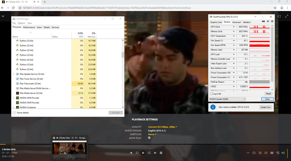

I have done the test and downloaded all the logs. I have also taken the captures of what happens when you choose different options in the client. I have notice if i choose convert automatically in plex the transcoder uses the GPU. If i choose anything else the transcoder dies and it doesn’t use the GPU and the video just buffers. Sorry i am not using P2000 but the K2200 also does the same thing as P2000. My P2000 is in another server and currently running.
I hope this helps and if you need anything else please reach out.
Plex Media Server Logs_2019-07-10_18-43-48.zip (895.2 KB)
@ChuckPa
This log is when Hardware transcode is off on the Plex GUI. Everything works smooth with no issues but uses lots of CPU with multiple transcode.
Plex Media Server Logs_2019-07-10_18-52-19.zip (931.2 KB)

I am using K2200 here which is fully unlocked. I am only playing one transcoded video here and not multiple.
Quadro K2200 Maxwell (1st Gen) GM107 D 1 1 1 Unrestricted YES YES YES NO NO NO NO NO
The card card is unrestricted and no limit. The only thing this card can’t do is H265 video. I am not playing H265 video in the test as log shows also. Where from here? I don’t want to move to Linux. Can you forward this information to your engineers that look after Windows so they can contact me. I can understand you only do Linux and that’s totally fine. I need help here.
From the screenshots you can clearly see that something is wrong with the transcoder and once you choose “Convert Automatically” it transcode.
If Plex doesn’t have GPU decoding it should fall back to Windows Software decoding and this is stated by plex and clearly doesn’t work. Poor design and coding? If it’s falling back correctly why is the video buffering and not continuing as normal?
I need some good answers and i am happy to do more tests as required.
