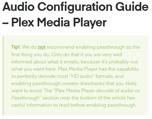

Why does that article repeat like 50 times to not enable it? And also windows volume control doesn’t work with passthrough enabled.

  1. The previously linked help article clearly states, multiple times, that passthrough should not be enabled. If what you are saying is true (that it should be enabled, and that the article is wrong), the documentation should be updated.

No, it doesn’t say that. It says (my emphasis)
We do not recommend enabling passthrough as the first thing you do. Only do that if you are very well informed about what it entails,
Which is sound advice. Due to the above mentioned circumstance that
I was referring more to the repetition of that recommendation throughout the article. The most concerning and confusing bit is at the bottom:
This basically makes it sound like you should never want passthrough on, because Plex processes the audio better. It even talks about that little LED light and stuff. Honestly, I’m not that informed about audio technologies and formats, so maybe I’m way off base. But my feedback to you is this is incredibly confusing. I mean, you could probably dissect the words and try to justify it, but I’m just sharing why I was confused.

It’s the first thing in the article??

guide does emphasize disabling passthrough seemingly more than important than enabling passthrough.
