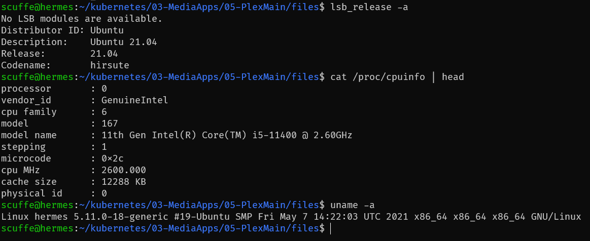

I’m a LST person in general but 21.04 running 5.11.0-18-generic (out of the box kernel) with the intel compute runtime packages installed has GPU offload with HDR working.

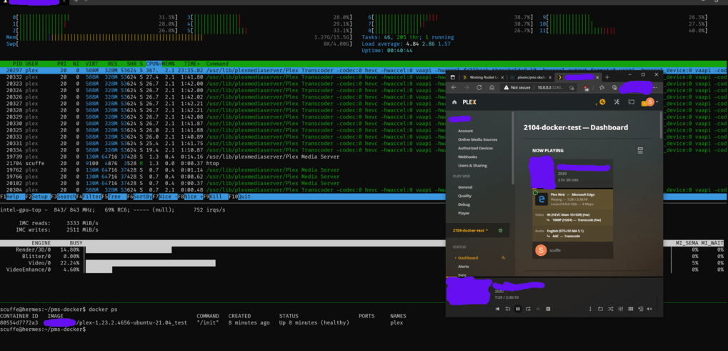

Initial tests with the plexinc/pms-docker container were unsuccessful. I was able to edit the dockerfile to reflect my bare metal install and now it’s working as expected.
I’m attaching my dockerfile that i used to build the image. you need to clone the plexinc/pms-docker repo and build the image with the attached dockerfile.

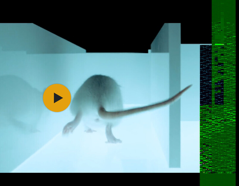

I had the exact same behavior, just different locations for the green artifacts. I read someone posting about how kernel 5.11 is the minimum you need to get it to work. I tried to use 5.12 from the ubuntu kernel ppa but it didn’t play nice, i also found out they since they provide those ones for “testing” none of the os specific patches are included.

In order to get the docker container working i had to change the pms-docker file from their repo to match my 21.04 install. I changed the base image to be from 21.04, removed all references to beignet, updated the neo references to the latest version and added the additional neo packages that are not in the install. You can reference all of that from the file in my first post.
There wasn’t anything extra i had to do to make it work.

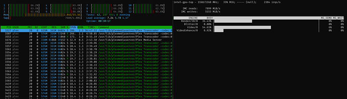

This is the performance profile under load. I ran 5 transcodes from a 4k file (2160p 10bit HEVC HDR 65Mbps) to different bitrates ranging from 2-20Mbps (PC, Vizio Smartcast, Roku, Nvidia Shield and an Ipad as clients).

Yup, Thats the exact same behavior i had in with oem-20.04b. The 5.11 kernel seems to resolve the green artifacts, its also the default kernel installed with ubuntu 21.04. Once 5.11/12 are fully backported to ubuntu 20.04 i plan on redeploying everything back to the LTS but for now this is allowing everything to work. This is the last screenshot i have of them before trying 21.04. The hardware transcode was working and i could see it in intel_gpu_top but the output was corrupted.
