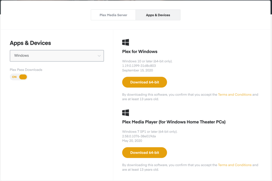

Maybe try Plex for Windows.
As SE56 said, use Plex for Windows. Also, make sure to enable hardware decoding under the “Player” tab in settings.
